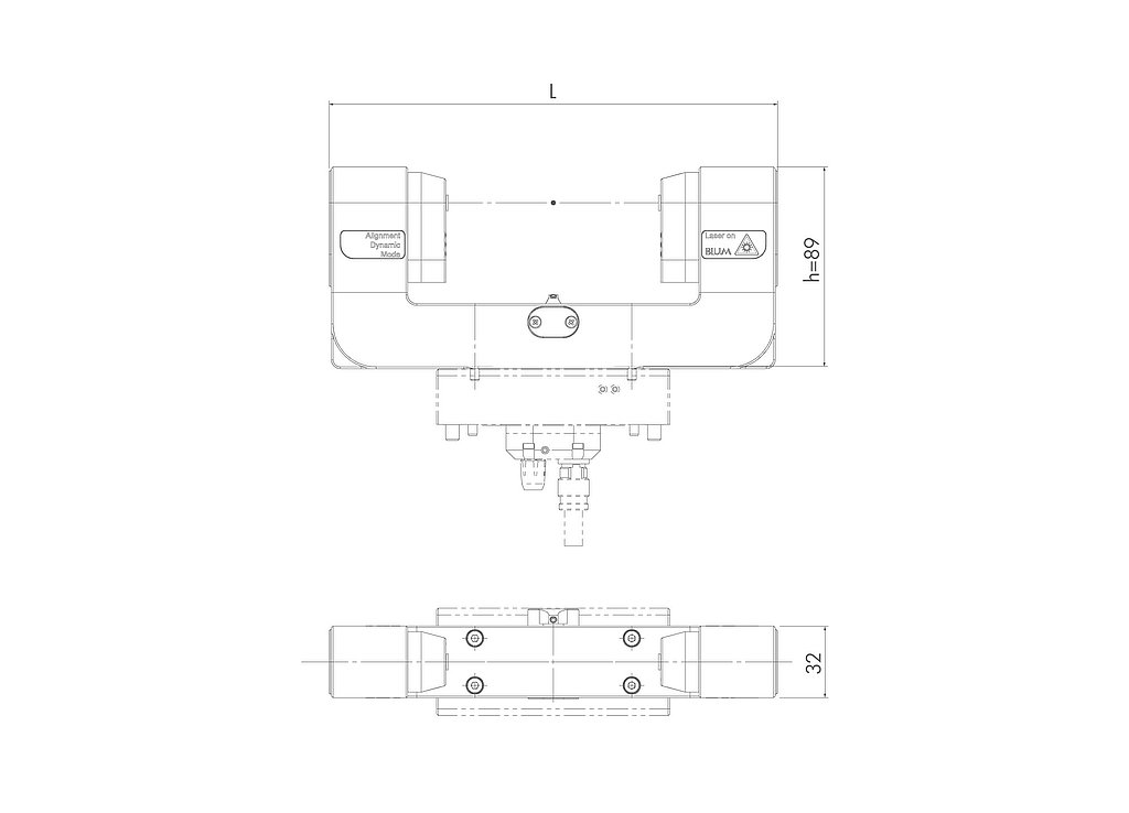

Technical data
System length | 150 mm | 200 mm | 260 mm | 300 mm | 400 mm | 500 mm |
Max. Tool Ø* | 36 mm | 120 mm | 314 mm | 498 mm | 1154 mm | 2087 mm |
Min. Tool Ø* | 5***/15 μm | 20 µm | 30 µm | 37 µm | 49 µm | 66 µm |
Repeatability** | 0.2 µm 2σ | 0.3 µm 2σ | 0.4 µm 2σ | 0.5 µm 2σ | 0.7 µm 2σ | 0.9 µm 2σ |
* Risk of collision if tool diameter exceeds opening width. Observe the operating manual! ** Depending on the installation situation and stability of mounting *** 5 μm possible, with adaptation of software parameters
